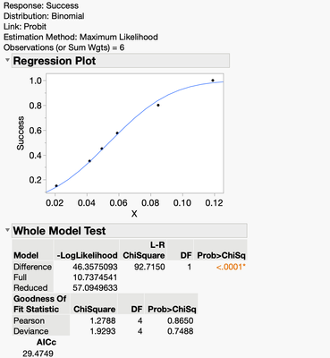

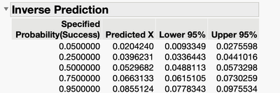

Dear JMP community,
I am fitting a probit regression between proportion of success and a continuous variable X. The screenshots below are the fit model outputs. I also got inverse predictions when the success are 0.05 ~ 0.95. I am wondering: 1) what are the confidence intervals for the parameter estimates, are they the Wald confidence interval? 2) what are the confidence intervals for the inverse predictions, are they the Wald confidence interval or calculated using the Fieller’s theorem? Thanks!
