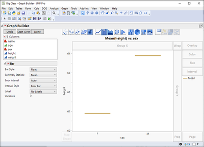

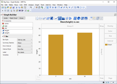

Could you show image of your bar chart as normally bar charts look like this in JMP
You could for example have bar style as Float and then you get something like this
-Jarmo
Re: uniform scaling of y-axis and getting bars to appear
Thank you. Yes, the float style is exactly what I'm getting (see attached) but the graph isn't responding to my attempts to change the style.

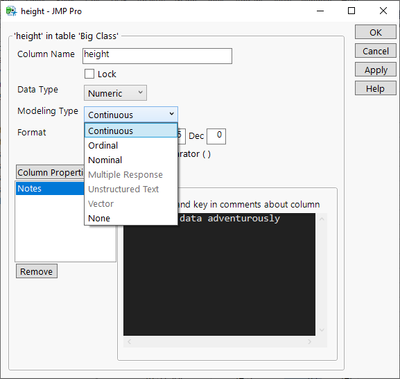

My guess is that you have non-continuous y-axis (maybe it isn't even numeric). If I change my height column to nominal, I will end up with graph like this
so make sure you have correct data AND modeling type for your column(s)
