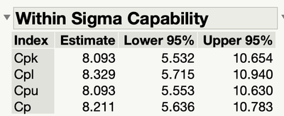

I was trying to replicate the confidence intervals for Cpk in JMP.  I found this page which details the formula:
https://www.jmp.com/support/help/en/17.0/#page/jmp/statistical-details-for-capability-analysis.shtml
This page says the equation is:
So this is the example I am trying to match,
since it is 95%, the lower confidence interval should be (32 is the sample sample size):
This equals, 6.075.  JMP says it is 5.532.  Am I doing something wrong or is this not the correct formula, why is it not matching?
When I use this calculation for Ppk, I get the correct answers, but not Cpk.
I am on macOS Monterey 12.6 and JMP Pro 16.0.0.

The formula looks correct, or at least close to others that can be found on the internet. Following your values, I get the same results as you both in JMP and with my hand calculations. I also tried several other examples and my hand calculations never match what JMP is providing. I think this might be something that you take to JMP Tech Support to see if they can determine what is going on.

You might also take a look at this page for more detail about how the CI is currently calculated. Your result at the top appears to be from a legacy platform that might not be up to date. The key difference is the use of DF that are not necessarily N-1.DF depends on how the sigma is determined. The developer is looking into this matter, too.

Thanks. I tried the new calculation and am still getting different results.    I forwarded an email to jmp support.
