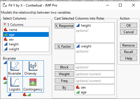

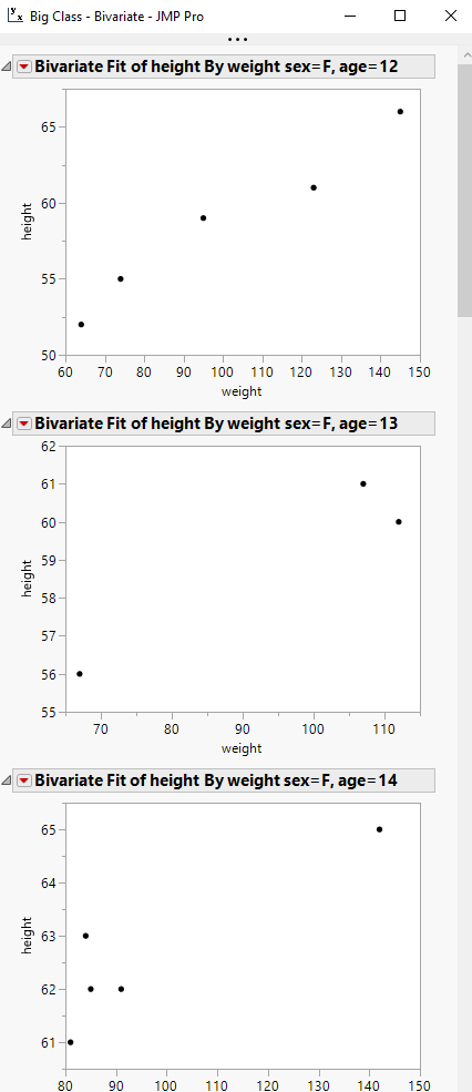

You should be able to do the separate analyses you are mentioning "male and female adolescent, male and female elderly etc", by specifying those columns as "By" columns in the analysis and graphical platforms you are running. The example below adds "Age" and "Sex" to a simple Fit Y by X for "Height" vs. "Weight"
and it produces the output for each combination of sex and age

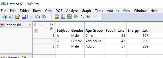

your description of your data, I believe the below is representative of what the structure is like?
If this is so, I think what you need to do, is to start off with the Distribution Platform, learning about the distributions of the data.  Are there any unusual issues?  I would then list out the questions about the data that you want answered.  Once you get to that point you may see what you need to do to answer the questions.  At least, you will be able to as the Community, a more specific question.

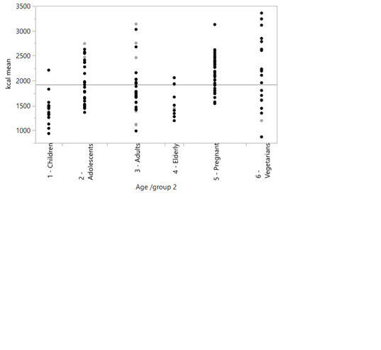

After using the fit X by Y function , the kcal intake as response, the age category as X factor and sex in the BY function, I have now got 2 graphs like the one below, one for the male and one for female.
What I  wanted to do was to have all the Groups in the same figure and be able to compare them also by Wilcoxio tests
