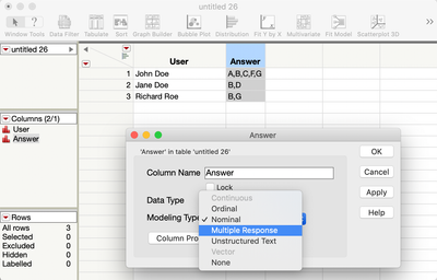

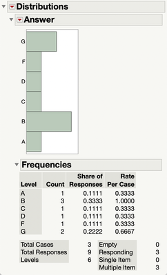

Jeff_Perkinson
Re: Counting elements in list (within a cell)
Make your answer column a multiple response modeling type and the Distribution platform will do that for you automatically.

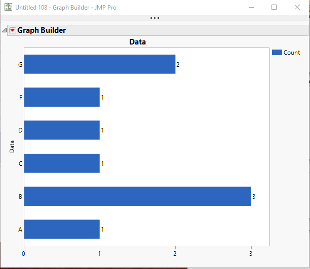

txnelson
Use the Text to Columns to move each letter found and then stack the columns that were created.  That will stack them and you can use the Data column for your axis on you bar chart.

dtStack = dt << Stack(
	columns( :Column 1 1, :Column 1 2, :Column 1 3, :Column 1 4, :Column 1 5 ),
	Source Label Column( "Label" ),
	Stacked Data Column( "Data" )
dtStack << Graph Builder(
	Size( 518, 456 ),
	Show Control Panel( 0 ),
	Variables( Y( :Data ) ),
	Elements( Bar( Y, Legend( 3 ), Label( "Label by Value" ) ) )

Jeff_Perkinson
-Jeff
Just to complete, this works great and allows the later use of Recode functionality (as some elements have commas within).
