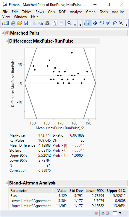

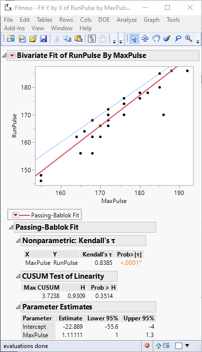

JMP 17 introduced Passing-Bablok Regression to the Bivariate platform:
The curve menu for this fit under the scatter plot provides a new command to start the new Bland-Altman Analysis in the Matched Pairs platform.

Re: Compare Analytical Methods (Pharma) in JMP
Thank you so much @Mark_Bailey for your input! This was exactly what I was looking for! Merci! :)
