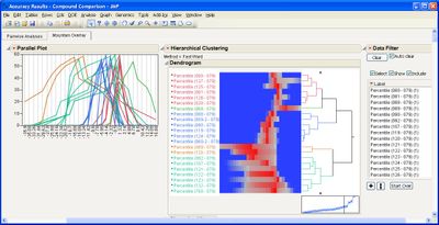

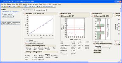

For example analyses, click Add-Ins > Method Comparison > Help after installing the add-in.  The add-in also includes four example data sets: "Compound Comparison", "Peak Expiratory Flow Rate", "Simulated Example", and "Systolic Blood Pressure".   Click Add-Ins > Method Comparison > Example Data to open them.
Some example screen shots are below.

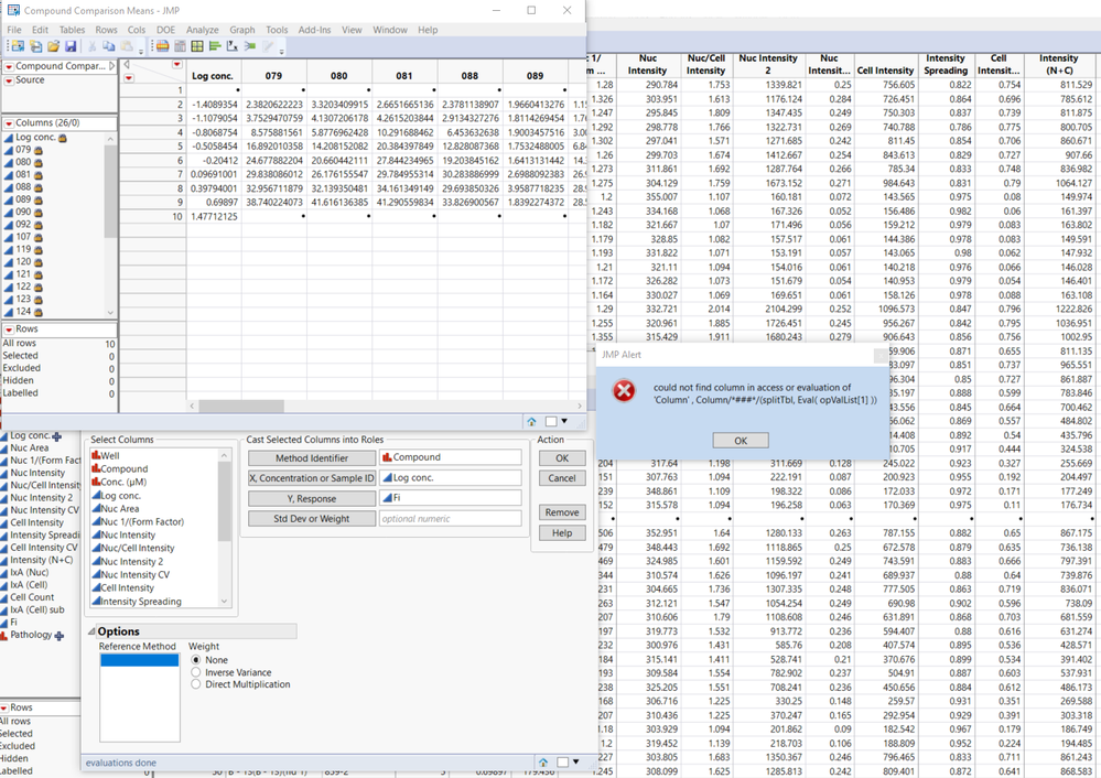

Hi @russ_wolfinger,

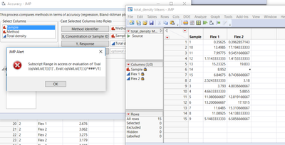

I recently downloaded the method comaprison add-in, but unfortunately, I can't get it to work. I installed the add-in and followed the first example using the provided data table. After hitting OK, I get the following error message:
could not find column in access or evaluation of 'Column' , Column/*###*/(splitTbl, Eval( opValList[1] ))
Any help would be much appriciated.
Thanks,
Hans
russ_wolfinger
Hi @Hanz,  In the dialog, that lower left box below "Reference Method" should be populated with values, so it appears something has gone wrong from the start.   From a freshly launched JMP session, please reopen the Compound Comparison data, then click Add-Ins > Method Comparison > Accuracy.  Select Compound and click "Method Identifier".   The lower left box should populate with values "079", "080", "081", ...   Please check your JMP log (Ctrl-Shift-L) and send any messages.  (From the error message you are currently getting after going further, opValList[1] should evaluate to "079" and find that column in the Means table.)  What version of JMP are you running?   Are you using any regional settings or language preferences?  What version of Windows?

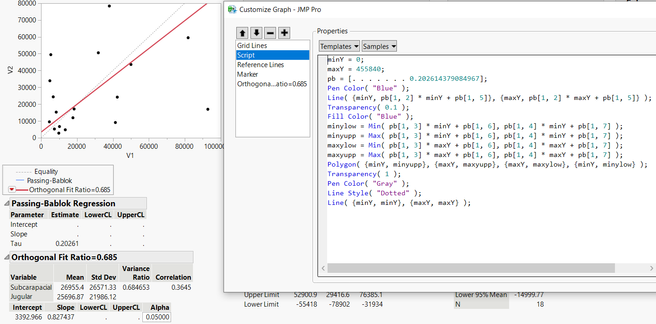

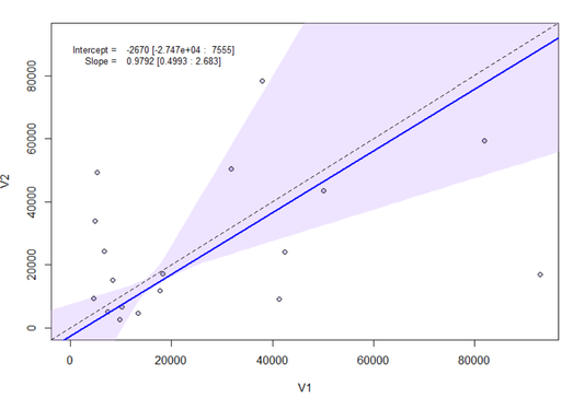

I am using the Method Comparison Add-in to fit a Passing-Bablok regression. The add-in works great because it also adds CI's for the regression estimates which is requested by many regulatory bodies. It also computes an additional orthogonal fit for comparison.
Now I am trying to calculate the predicted value at a given X point, with Confidence Intervals using the PB fit. Is there a way to do this? because the PB fit does not have a red triangle with options.

Hanz
Hi @russ_wolfinger ,
Thanks for your fast response. Relaunching JMP worked!
I noticed now that the Action button "Remove" acts as a kind of refresh. In other words, after adding the method identifier, I have to hit "Remove" to update and populate the dialog box in the lower left corner. Afterwards, I can proceed with the analysis as described in the help document.
For your info, I'm running JMP 12.1.0 (64-bit) on a Windows 10 Enterprise 64-bit system with no regional settings (that I know of) and English as the default language.

@david_arteta, no direct way to get at these.   One easy thing to try would be to create your own formula column using the Passing-Bablok intercept and slope estimates.    More ambitious would be to parse these values out from the appropriate table box using JSL.    The ultimate would be adding the red triangle as you indicate.   I'm not planning to tackle this any time soon so if anyone is willing to give it a go I'd be happy to incorporate updates into the add-in.    Alternatively, it may be a good time to be voting for the formal addition of Passing-Bablok to the JMP Bivariate platform.

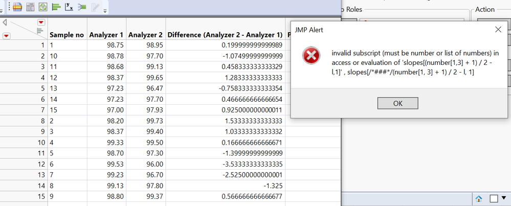

A_Tomczyk
Hi, @russ_wolfinger ,
I am trying to perform Bland-Altman plot and Deming regression.
I have data in format like below:
I am receiving an error like:
Any idea what is going on...?
Regards,
Agnieszka
russ_wolfinger
Hi @A_Tomczyk ,   Would you be willing to send me the JMP table and I can investigate further?    Please attach it here or email me at russ.wolfinger@jmp.com.    Kindly,  Russ

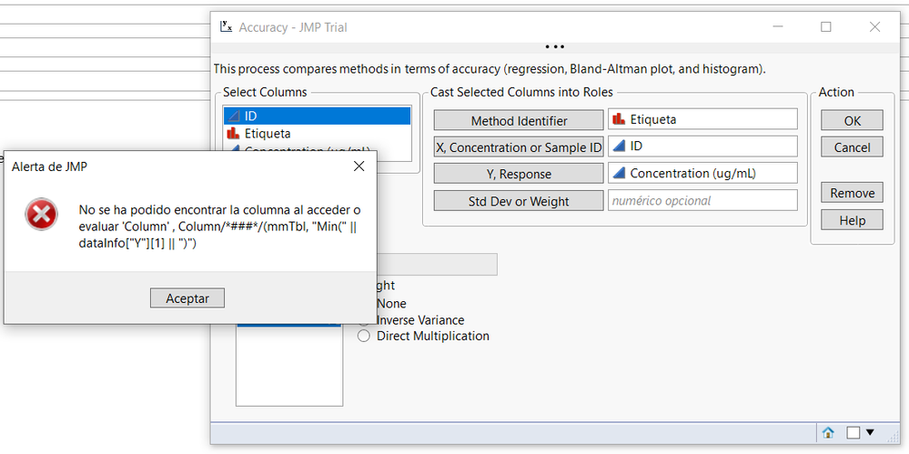

ainhoa
I have a trial version of JMP 15 and I have problems with Accuracy test (I downloaded the add-ins from this page). I have a JMP alert when I run the test:
 The alert says: The column has not been found when accessioning or evaluating “Column”.
 Could help me?
Thanks
russ_wolfinger
Hello @ainhoa ,  This likely has something to do with Spanish language settings.   Would you be able to send your JMP data table so we can investigate further?   Please email it to russ.wolfinger@jmp.com.    In the mean time, if you would also please check if you can run the first example in the help document using the Compound Comparison data provided.   In addition, if you happen to have access to a machine with English settings please try it there.   Sorry for the bother--we'll work towards a resolution for you.
ainhoa
Thanks a lot @russ_wolfinger . I'll send you the table by e-mail and I'll try to do what you have proposed.
h-berland
Hello everyone,
I have found trigger for why the "Reference method" is not correctly populated when selecting Method Identifier:
If you drag-and-drop Compound into the field, Reference method is not populated, but if you select Compound and click on the Method Identifier button, Reference method is correctly populated.
@ainhoa @Hanz
Best regards,
Helge
russ_wolfinger
Thank you Helge, yes, the button does this extra work and it should be used instead of drag-and-drop.   Russ

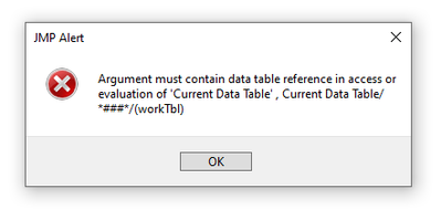

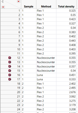

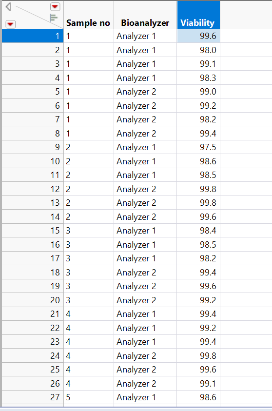

jzawadzka
I receiving an error:
Could you please help me with this issue?
Regards,
Joanna
jzawadzka
Sorry, here is the data format: pic1.PNG

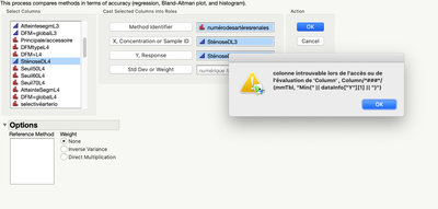

Etienne-88
It seems that i have the same problem than ainhoa
Indeed, when i perform method comparison and accuracy test with my datas i have the following error message:
Can you help me?
Thank you 
russ_wolfinger
@jzawadzka   Apologies for the long delay.   Would you be willing to send the full JMP table  to russ.wolfinger@jmp.com ?  I can try to reproduce the error and implement a fix.  Based on what you sent I'm not sure what is happening.
@Etienne-88  this almost surely has to do with language settings.    Note the error message is searching for column "Min" where on your machine this would be in French.  The add-in has only been developed for English and I have not yet had the chance to implement a fix that would be language agnostic.  One idea for a fix is to reference the column by number rather than name.   In the mean time, you have access to the JSL by clicking View > Add-Ins and could potentially modify the code to work.
