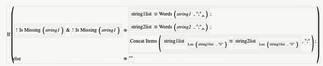

While @txnelson and @Craige_Hales gave you some interesting and useful options, if I've understood your situation correctly, it can be done in a formula without loops.
Here's the formula I ended up with, first as a picture and then in JSL (which can be pasted into the Formula Editor).
If( !Is Missing( :string1 ) & !Is Missing( :string1 ),
	string1list = Words( :string1, ";" );
	string2list = Words( :string2, ";" );
	Concat Items( string1list[Loc( string1list, "0" )] = string2list[Loc( string1list, "0" )], ";" );
This uses the Words() function to convert your strings to lists. It uses the Loc() function to return a matrix of locations of the 0s in string1 and uses that as a index for both string1list (on the left side of an assignment) and string2list (on the right side of that assignment). Finally, the Concat Items() function converts the list back into a semicolon delimited string.
If any of this is confusing or doesn't make sense, let me know and I'll explain further.
