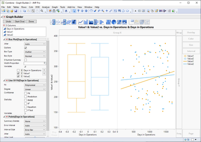

Hello,
can I have combine chart on X axis when 1 part will have boxplot - no X axis and second part will be fit with X axis additional data. Charts created separately in attached file

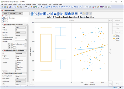

I think you have to have additional X-axis (you can for example create transform column or use existing one) and then modify it as needed. In this example I have used Days in Operations as the x-axis but I have removed it from the BoxPlot variables
From here you can remove tick marks and the label
Graph Builder(
	Size(706, 589),
	Show Control Panel(0),
	Variables(X(:Days in Operations), X(:Days in Operations), Y(:Value1), Y(:Value2, Position(1))),
	Elements(Position(1, 1), Box Plot(Y(1), Y(2), Legend(20))),
	Elements(Position(2, 1), Line Of Fit(X, Y(1), Y(2), Legend(16), Confidence of Fit(0)), Points(X, Y(1), Y(2), Legend(17))),
	SendToReport(
		Dispatch(
			"Days in Operations",
			ScaleBox,
			{Label Row({Automatic Font Size(0), Automatic Tick Marks(0), Show Major Labels(0), Show Major Ticks(0), Show Minor Ticks(0)})}
		Dispatch({}, "X title", TextEditBox, {Set Text("")})

Thank you. I was able to replicate.
