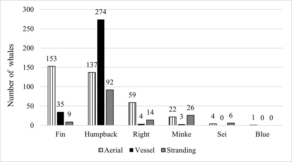

The first graph (see example "Total Number by Platform") is the total number of 6 different species of whales detected from three different platforms (aerial, vessel and stranding records).

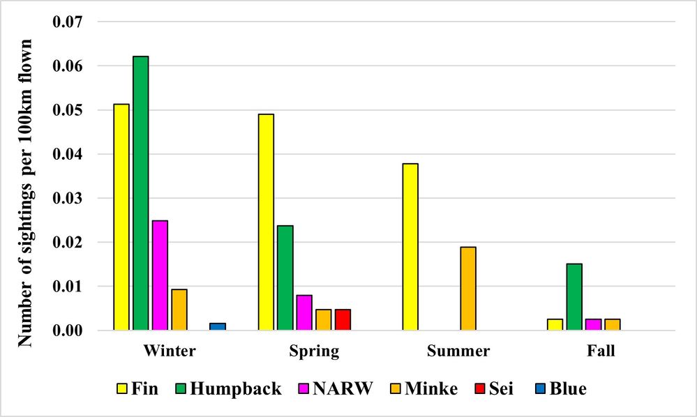

The second graph (see example "Species by season") is the number of whales sighted per 100 km flown by season and for each species.

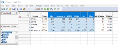

Copy your data into a JMP data table like

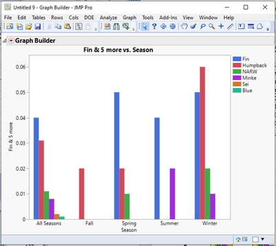

Open Graph Builder
Select all 6 Whale columns and drag them to the X drop area
Click on the Bar Chart icon
Drag Season to the X axis drop area
Select all of the whale columns
Drag all of them to the Y axis drop area
The same process is used for the Total by Platform spreadsheet
