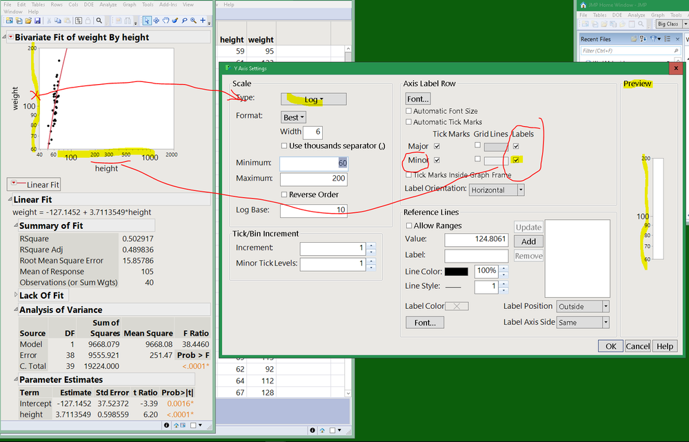

I want to generate a scatterplot for two continuous variables. As each of these variables has a few outlying observations, the scatterplot should have log-transformed axes but with the original variable values as tick marks,

Make the scatterplot, then double-click each axis to get the axis dialog. On the left-hand side of the dialog you can choose the log transform.
If you need a scripted solution, use the red triangle to save the script; you'll see the log transform command in the script.
There are a bunch of options to control the appearance of the axis, and a preview.There are a bunch of options to control the appearance of the axis, and a preview.

Craige_Hales
Re: How can I generate a scatterplot with log-transformed scales on the axes?

Dear Craige,
Thank you very much for your excellent hint which is a perfect solution for my problem.
