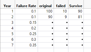

mquyen
Level I
Re: Column formula dependency cycle error
Thanks for your suggestion. This is how I would set it up, but it only iterates for 2 rows and would take to long for just that row.
New Table( "test",
	Add Rows( 7 ),
	New Column ("Year", Set Values ([1,2,3,4,5,6,7])),
	New Column ("Failure Rate", Set Values ([0.1,0.1,0.15,0.2,0.25,0.3,0.35])),
	New Column( "original", Set Values( [100, ., ., ., ., ., .] ) ),
	New Column( "failed", formula (:Failure Rate *:original) ),
	New Column( "Survive", formula (:original - :failed ))
Wait( 2 );
For Each Row(
			If( Row() != 1,
				:original = Lag( :Survive )
