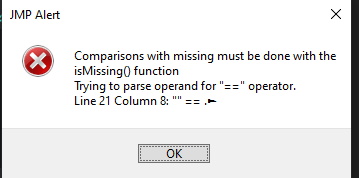

@vince_faller I think I remember seeing something about that, but I'm not sure anymore in which case it was and which function, at least with JMP16 the IsMissing() does work with strings. Maybe it was with comparisons like "a" == ., as it will throw error:
-Jarmo
-Jarmo

Also @jthi didn't `ismissing()` not used to work on strings?  I remember it always killing my regexs (hence why I used `isstring()` here).  Though I tried it all the way back to 14.3 and it seems to be fine.
