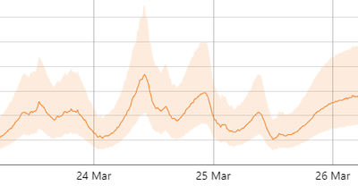

Hi - I am trying to write a script that will plot my computed regression value along with my custom computed upper and lower error bars.  That is, for each independent value, my chart would plot the dependent (regressed) value, the upper bound, and the lower bound.   My chart would look something like the example below, ideally with the error range shaded.  Thanks in advance!

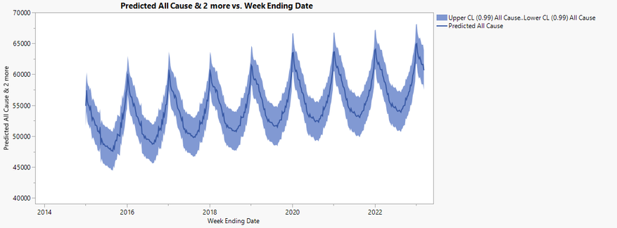

I apologize as I was not very clear/helpful.  In the script available using the 'View More' button in the very first post, after all of the statistical analysis is a graph with a prediction, confidence limits, and a shaded area.  In graph builder, you could:
  • Add time to x axis
  • Add prediction, upper and lower confidence limits to y axis
  • Change to line and remove the smoother
  • Right click inside the chart area and select Add > Area
  • On the bottom left, under 'Area', change the Area Style to Range, and under Variables uncheck the prediction, so you only have time, upper, and lower confidence variables checked.
  • On the bottom left, under 'Line', uncheck the confidence variables, so you only have time and prediction checked.

Thank you ih.  Sorry, I think my original question was unclear.  I only need to plot my computed values as a time series.  (I do not need to do seasonal modeling.)  I have already computed my regression and my upper and lower errors and I just need to plot them with the error range shaded.  I looked through the link you sent, to no avail.  I am probably missing something.

Thank you ih - this should help!
