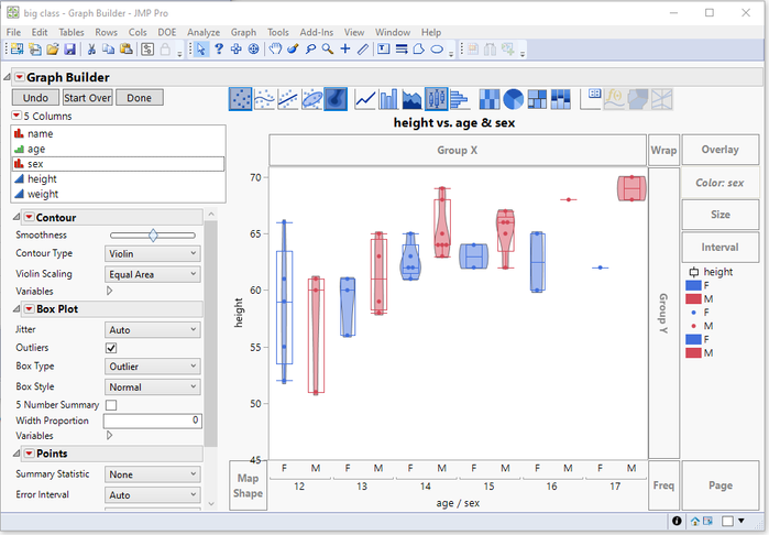

Good afternoon all,
I wanted to create a graph in which the points fell exactly within each box-plot and the related violin plot.
Using the graph builder, I realized that the points don't line up inside the box.
Anyone have any idea how to fix this?
I attach photos.

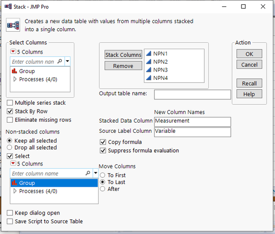

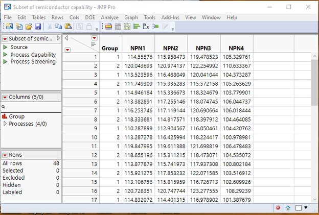

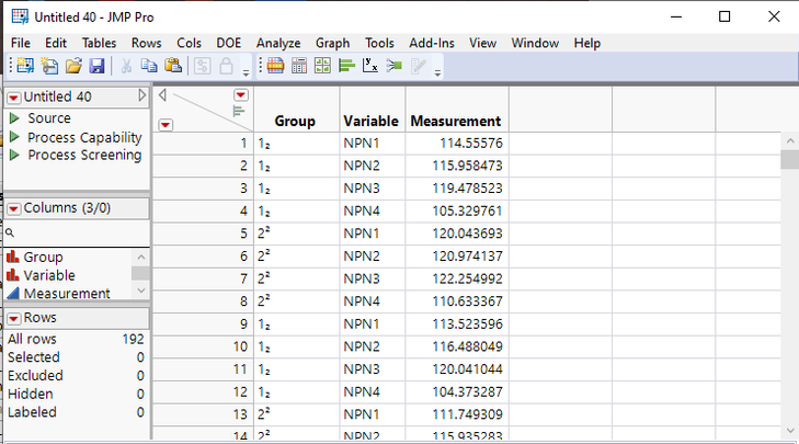

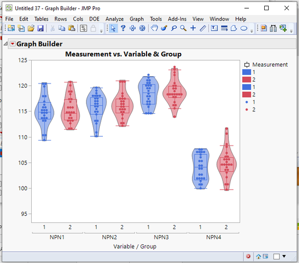

All that has to be done to take the data table as you describe it, and pass it to Graph Builder to create the display you want it to stack the data and then run the Graph Builder.  To illustrate, given the following table with 4 continuous variables(it could have as many continuous variables as needed),
One just uses
     Tables=>Stack
and stacks all of the continuous columns, and also makes sure the Group column is also carried along
I have also renamed the Stacked Data Column to Measurement and the Source Label Column to Variable
Now the resulting data can be used by Graph Builder to create the desired graph
Below is a script that first creates the sample data table from one of the sample data tables supplied by JMP, then it stacks the data, and finally it uses Graph Builder to create the above chart
One just uses
     Tables=>Stack

THANKS YOU VERY MUCH,
thanks to your valuable advice I finally reached the goal.

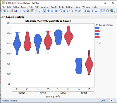

I'd like to know how to display for example group squared or 2 as subscripts.
Or in the previous example display height squared.
So in general how to display the axis labels with superscripts or subscripts.
For example if I wrote BMI (Kg / m ^ 2) on the ordinate axis how do I tell JMP that "^ 2" is squared avoiding the ^ symbol?
Best wishes
txnelson
Re: Box-plot with points aligned in box plus violin plot
JMP supports both UTF-8 and UTF-16 Unicode standards. See the Scripting Guide for more details.  It allows one to embed these special characters without special handling.
JMP can also print such characters using the escape string, "\!" followed by the Unicode string.  So to include what you specified as a label, I would open a script window and place the following print command in the window
print("BMI (Kg / m\!U00B2)");
After to run this line, the following will be in the log, which you can then cut and paste into the label
"BMI (Kg / m²)"
I wish there was a more direct path, but I am not aware of one.  Details on the full Unicode character set can be found in the Scripting Guide
