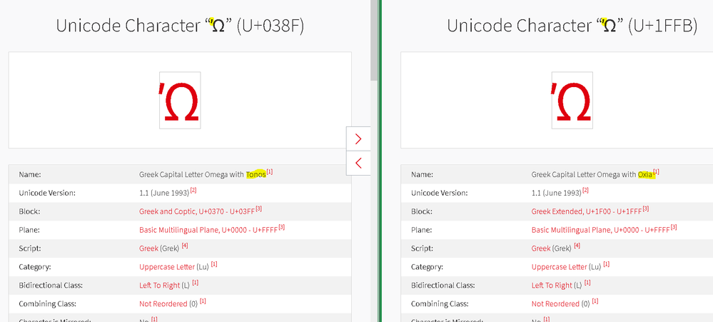

How to quickly implement this Unicode lookup using JSL?
That is, I give a character Ώ and want to see how it is qualified in Unicode
Thanks Experts!
Craige_Hales
Super User
回复: +Re: Column Formula to convert Unicode to symbol
Fascinating, learned something I didn't expect:
c = "Ώ"; // the test character
table = [=> ]; // build the complete lookup table 1..FFFF
For( i = 1, i <= 65535, i += 1,
	code = Hex( i, "integer", padto( 4 ) ); // 0001 ... FFFF
	char = Blob To Char( Matrix To Blob( J( 1, 1, i ), "uint", 2, "little" ), "utf-16le" );
	If( !(table << Contains( char )),
		table[char] = {}; // make a list to hold extra codes for the same character
	Insert Into( table[char], code ); // add character to the list
lookup = table[c]; // get the codes for the test character
For( i = 1, i <= N Items( lookup ), i += 1,
	// I don't know anything about this site, but it does retrieve the two characters 4jun2024
	Web( "https://www.compart.com/en/unicode/U+" || lookup[i] ); // open a web page for each character in the list
That's a brute force solution, but I'm not sure how else to do it! @hecht_jmp
Two different Unicode characters are the same code point.Two different Unicode characters are the same code point.
