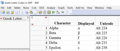

I want to make JMP table that will have a column with the unicode shortcut for a symbol and then have JMP display the symbol (wiht a formula) in another column.  In the screen shot below, I would like the column Displayed to have formula that uses the column Unicode as an input and that shows the displayed symbol result.
The table below was created by manually typing the Alt+Code.
I can't figure out how to do that in a column formula. Any help would be appreciated

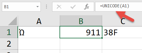

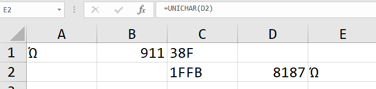

  • There are functions available in excel
