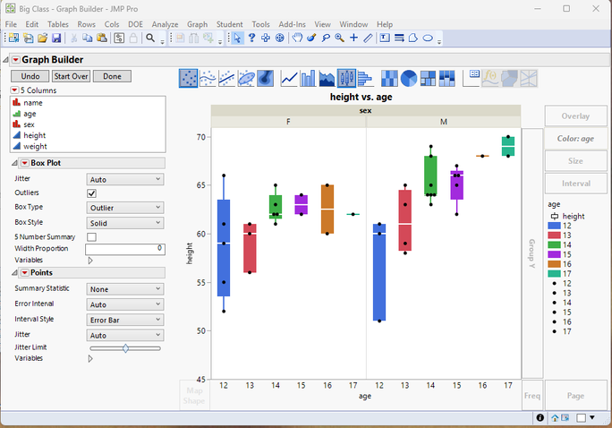

Here is a similar graph to what you are showing in JMP 18
I changed the points to the color black so they are visible
The same similar results are available back through JMP 15.  However in JMP 14 a solid box plot does not honor the Color column

Here is the example that I have been using run in JMP 17.2.  Doesn't it give you what you want?

Re: Color Box-plots
It does, now it worked. Thanks

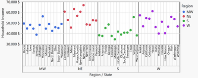

For some cases it even makes sense to use the color for the "outer" categories:
