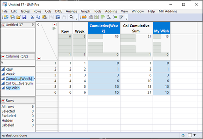

Hello, I am quite new to writing JMP scripts and primarily use "Edit Formula" for my work. I have been browsing solutions related to Col Cumulative Sum and could not find one for my specific problem. The simplified version of my data table is as follows.
RowWeekCol Cumulative SumMy Wish
1110
2231
3363
44106
551510
662115
The formula below works if the current row value of "Week" is fixed or if I have two separate columns "Week" and "My Wish."
If( Row() != 1,
	Lag( Col Cumulative Sum( :Week ), 1 ),
	0
The issue is that the value of the previous row's "Week" is fixed but the current row's is not. And I only have one column "Week" to work with. I am developing a formula that simulates progression based on the previous simulation value. I am simulating the current row's "Week" value based on the previous row's.
Suppose I am working on Row 4 in the column "Week." I want to cumulatively sum all the previous "Week" values without calling the current "Week" value in the function. Otherwise, it creates an illegal reference or cycling problem in my case.
I tried using subscript instead of lag since the lag function calls the current row's "Week" value. It did not work.
If( Row() != 1,
	Col Cumulative Sum( :Week )[Row() - 1],
	0
I hope my explanation was clear enough. Thank you for your time and expertise in advance. I use JMP Pro 17.

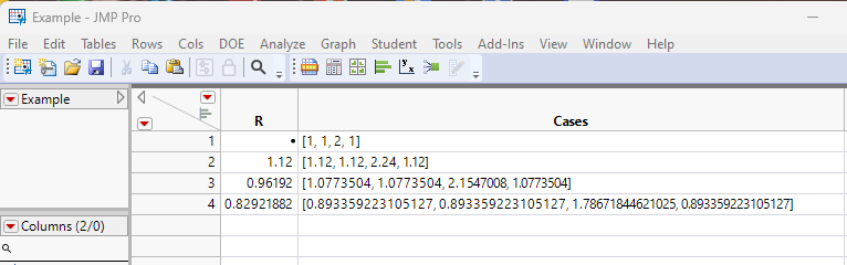

Here is my solution, however, it does not match your solution.  I believe your calculations as shown are incorrect for Row 3. See my script, which includes your sample data table.
Names Default To Here( 1 );
dt = New Table( "Example",
	Add Rows( 4 ),
	New Column( "R",
		Numeric,
		"Continuous",
		Set Values( [., 1.4, 1.67, 2.3] )
	New Column( "Cases",
		Expression,
		"None",
		Set Values( {[1, 1, 2, 1], Empty(), Empty(), Empty()} )
// The calculation script
casesSum = 0;
For(i=2,i<=nrows(dt),i++,
		Eval( Eval Expr( casesMatrix = Expr( :cases[i - 1] ) ) );
		:R[i] = :R[i] * (1 - (Sum( casesMatrix )+casesSum) * 4 / 100);
		:Cases[i] = casesMatrix * :R[i];
		casesSum = casesSum + sum(casesMatrix);
// Row 3 R does not seem to be correct
// I can not come up with .71, I come up with .96192
show(1.4 * (1 - (5 * 4/100)) );
show(1.67 * (1 - (10.6 * 4/100)) );

You can deduct current weeks value from the cumulative sum
Col Cumulative Sum(:Week) - :Week
