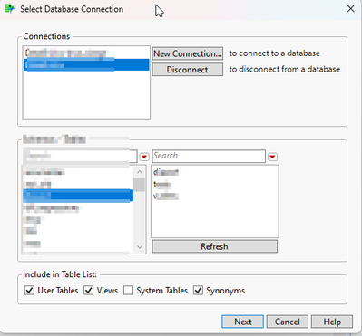

Is there a way to close the database connection before running the script?
I have an SQL script that crashes JMP if there's an open connection, so I'm trying to figure out a way to close all the connections before running the script.

Here is a previous Community Discussion that provides an answer
How to Disconnect from a database via script

If I remember correctly New SQL Query and Open Database will close the connection after query is done.
https://www.jmp.com/support/help/en/17.2/#page/jmp/sql-functions.shtml?os=win&source=application#ww5...
There is not a command to close an ODBC connection established with New SQL Query() because New SQL Query() always closes the connection after performing the query.
