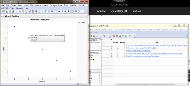

I have created a data table and used the EventHandler function to make one of the columns hyperlink to a website when clicked.
What I want to do now is to put this data into Graph Builder and when the points are clicked they open the website pertaining to the row. Is this possible? I have used the column as a label, but this doesn't work as it isn't clickable.
I have attached a small example table where it shows the data table and graph side by side and where the cloumn is labelled - it is this label in the graph I'd like to be hyperlinked.

Here is an example script that uses Make Row State Handler to do what you want.  It does not require your  Event Handler, so I remove it.  I can be left in if you want it, but it is not required.
Names Default To Here( 1 );
dt = New Table( "click and Link",
	Add Rows( 5 ),
	New Script(
		"where vs. Position",
		Graph Builder(
			Size( 522, 454 ),
			Show Control Panel( 0 ),
			Variables( X( :Position ), Y( :where ) ),
			Elements( Points( X, Y, Legend( 3 ) ) )
	New Column( "Position",
		Numeric,
		"Continuous",
		Format( "Best", 12 ),
		Set Values( [1, 2, 3, 4, 5] ),
		Set Display Width( 56 )
	New Column( "where",
		Numeric,
		"Continuous",
		Set Values( [5, 4, 3, 2, 1] ),
		Set Display Width( 48 )
	New Column( "Link",
		Character,
		"Nominal",
		Set Selected,
		Set Values(
			{"https://en.wikipedia.org/wiki/List_of_states_and_territories_of_the_United_States",
			"https://www.bbc.co.uk/home/five/beta", "https://www.linkedin.com/feed/",
			"https://www.marketwatch.com/story/10-things-britain-does-better-than-america-2016-04-06",
			"http://www.astonmartin.com/en/configure"}
		Set Display Width( 430 )
	Set Label Columns( :Link )
f = Function( {a},
	Show( dt );
	If( N Rows( dt << get selected rows ) > 0,
		Web( Char( dt:link[((dt << get selected rows)[1])] ) )
rs = dt << make rowstate handler( f );
Graph Builder(
	Size( 522, 454 ),
	Elements( Points( X, Y, Legend( 6 ) ) )
This could also be done by adding a graphics script to the frame box() in the chart.
gb = Graph Builder(
	Size( 522, 454 ),
Report( gb )[FrameBox( 1 )] << add graphics script(
Jim

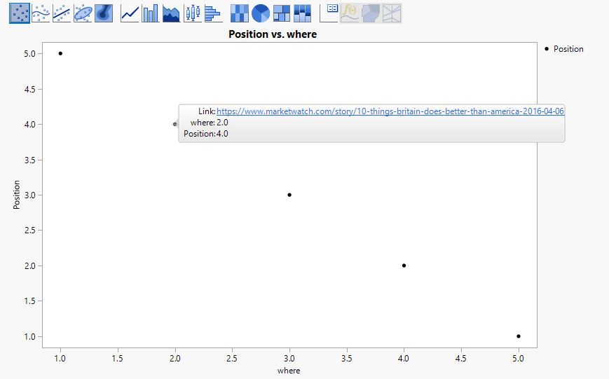

Re: Clickable Links in Graph Builder which Opens Website/ Image or Directory
Try opening your table in JMP 15.0 and creating a scatter or any other visualization in Graph Builder.
The value for the "Link" column will show as a hyperlink in the hover label automatically - click on it to launch the corresponding web page.
You also have the option of not having an expression handler in the data table column (to avoid the issue you described) and have the launching behavior only in the Graph Builder hover labels by taking advantage of a new JMP 15 feature called Gridlets. You could even build the URL on-the-fly based on other column values.
For more details, please check https://www.jmp.com/content/dam/jmp/documents/en/support/jmp15/using-jmp.pdf, page 532.
