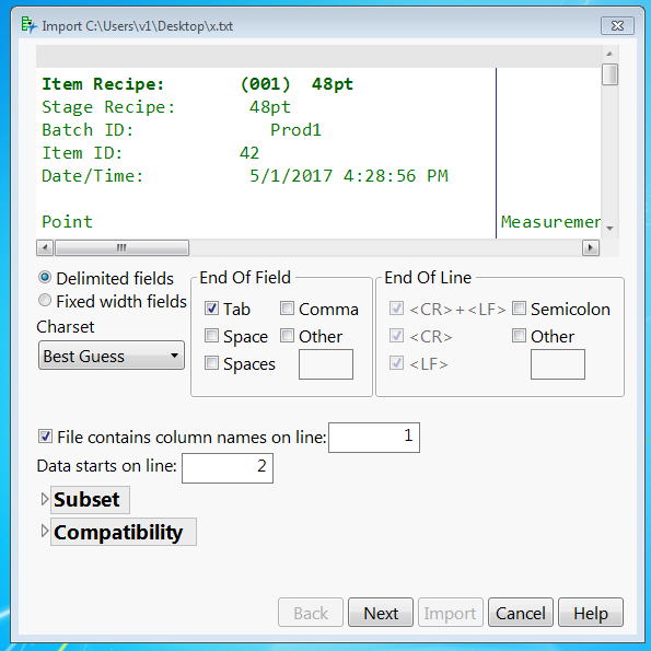

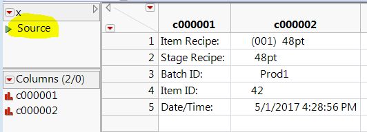

Nice description of the problem, and I think your plan will work. You can use the text import preview wizard to do part of the work. By limiting the number of lines to 5, you can get the header, and by choosing fixed width fields you can get two columns (or maybe spaces, plural, would work even better for the delimiter). (If my cut-and-paste of your data messed up tabs and spaces you might need to tweak the column delimiters a bit). The source script is in the table and you can grab a copy of it for your bigger script:

Next, import again, skipping the 5 lines, and grab that script too:

All of the JSL above was written by the text import preview wizard and stored in the source script attached to the table.
The Subset section has part of the answerThe Subset section has part of the answer
