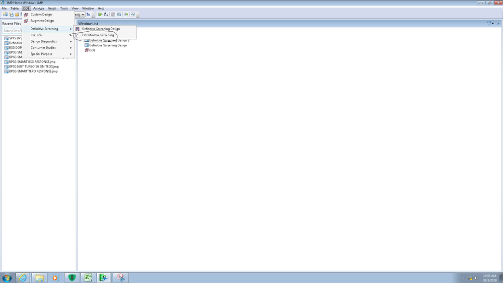

Is this how we analyze the DSD table?
JMP DSD.pngJMP DSD.pngR
Rgrds
Irfan
txnelson
Re: Classical Screening design vs Definitive Screening Design
If you already have a defined DSD, and you are just looking to analyze the data, the answer is yes.  If you need to setup a DSD, then you would select Definitive Screening Design.
