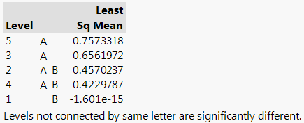

1. Is Sample (time) significant?  Answer: Yes.  See the Fixed Effect Tests section of the Fit Model.  The F-test has a p-values = 0.0025.
2. If so, which times are different?  Answer: Tukey Analysis shows that time 1 is significantly different from 3 and 5.  No other differences are significant.
3.  Does complications have an effect?  Answer: No.  The Complication main effect is not significant, and neither is the Sample*Complication interaction.  The interaction would indicate if the sampling time effects differ for patients with and without complications.  There is not strong evidence that this is the case.  See the Fixed Effect Tests for that as well.
