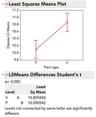

 I tried modeling the data with a Response Surface Method (RSM). Rep(order?) seems to have an effect, so in model 2 I made that a Random Effect.
I'm not sure what you were hoping to find, but this is very interpretable data, and the study design is just fantastic too.
Fit Model(
	Y( :Disease ),
	Effects(
		:Name, :"Assessment time (DAI)"n & RS, :Plant type,
		:Name * :"Assessment time (DAI)"n,
		:"Assessment time (DAI)"n * :"Assessment time (DAI)"n, :Name * :Plant type,
		:"Assessment time (DAI)"n * :Plant type
	Random Effects( :"Rep (Order)"n ),
	Personality( "Standard Least Squares" ),
	Emphasis( "Effect Leverage" ),
	Method( "REML" )
I changed the DAI column to numeric continuous, and the Rep Column to Numeric Continuous.
