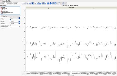

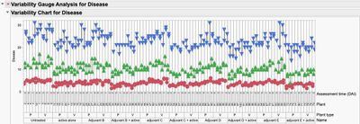

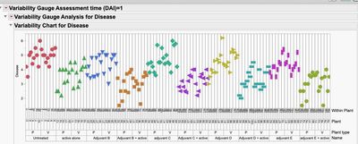

4. A graphical look at the data without any summarization shows the time periods (DAI) are the largest source of variation in the study.  This may be expected and may be of no interest (hence why you may want to look at the data by DAI), but also notice the variation increases with DAI.  There may also be some "outliers" in your data.
Colored by DAI

 Colored by Name for DAI=1
