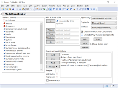

perhaps it is worth you try this approach: Full Factorial Repeated Measures ANOVA Add-In
it will run a mixed model where the mice are random effects. I am just not sure about the full factorial approach that would use the distance as random as well.
it should look something like this:
and
let us know if it helps.

First of all, thank you so much for taking time to reply to my request. I have tested the proposed solution and I think that the full factorial repeated mesure is a correct way to analyze these data. Given the small size of my groups, I was wondering whether you would advice to go for a nonparametric test, and which one would be adapted for the structure of my data?
