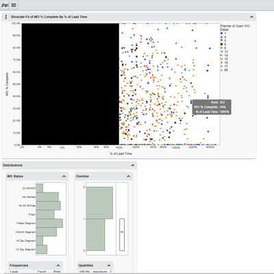

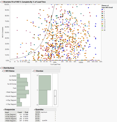

I have a set of charts that I want to save as an interactive HTML, but when the charts show up as a web page part of one of the charts is blacked out.  Could this be due to the chart displaying too much data?  I've tried with Chrome, Firefox, and Microsoft edge and they're all having the same problem.
Charts Displayed in JMP:
Charts displayed as Interactive HTML:

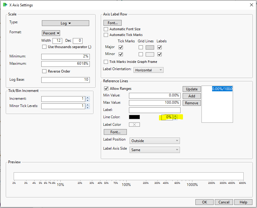

The blacked out area is a reference range on the X axis with an opacity of 0. Opacity0RefRange.PNG
JMP treats this as completely transparent, but due to a bug in our Interactive HTML export, an opacity setting of exactly 0 is ignored causing the reference range to draw completely opaque.
I see a couple of options for anyone running into this issue until the bug is fixed.
1. Remove the reference area.
2. Use an opacity value of 0.0001.
In the script of the .jrp file you provided, the last parameter of the Add Ref Line function is the opacity set to 0.0001.

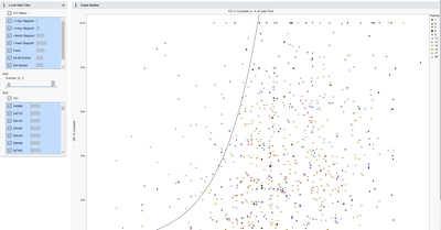

I went back and remade the graph and put all my distribution charts as local data filters and that seemed to do the trick.
