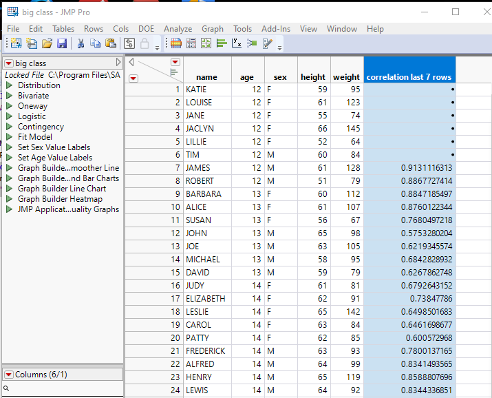

if you want to go ahead with your proposed rolling correlation, here is a formula that can be used to calculate that.  This example is using the Big Class data table from the JMP Sample Data Library
     Help=>Sample Data Library
If( Row() >= 7,
	y = :height[Index( Row() - 6, Row() )];
	x = :weight[Index( Row() - 6, Row() )];
	lin = Linear Regression( y`, x` );
	Sqrt( lin[3]["RSquare"] );
Attached is the sample data table with the applied formula
