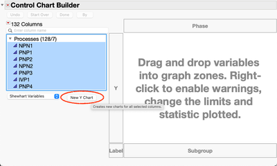

It's easy to get lots of charts from Control Chart Builder as well. Use the "New Y Chart" button below the list of columns and you'll get one chart for every column you've got selected.
-Jeff
-Jeff
