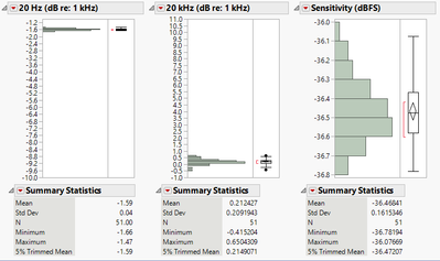

Hi, I think this should be a quickie, but I'm stuck on it: How do I change the format of all the Summary Statistics of a Distribution report at once?
After formatting as I'd like, the auto-generated script shows to change it for every entry of the distribution individually like so:

Re: Changing Summary Statistics Format of Distribution - JSL
Hey Mark,
Apologies if my initial question wasn't clear.  I also realized that I didn't copy the important part of the code in the original post.
The code snippet you supplied works well for a single Y column, but what I was looking to do was to change the format of all the Y columns that are included in the distribution with one line of code rather than multiple.  So basically rather than specify "NumberColBox(X)" to change the Xth Y Column, I'd like to just specify something like "NumberColBox" to change all of the Y Columns.
Does that make more sense?

Here you can see that I've customized the summary statistics using the following:
SummaryDist << Customize Summary Statistics(
	Std Err Mean( 0 ),
	Upper Mean Confidence Interval( 0 ),
	Lower Mean Confidence Interval( 0 ),
	Minimum( 1 ),
	Maximum( 1 ),
	Trimmed Mean( 1 )
and then I used your code to change the 20 Hz Y column of data to 2 decimal places:
SummaryDistRep["SummaryStatistics"][NumberColBox(1)] << Set Format("Fixed Dec", 15,2);
But the remaining y columns for 20 kHz and Sensitivity haven't had their format changed.
Expanding just a bit on @Mark_Bailey's solution, changing the last line to this would apply this formatting to only items inside outlines boxes called 'Summary Statistics':
(dist rep << XPath("//OutlineBox[text()='Summary Statistics']//NumberColBox")) << Set Format( "Fixed Dec", 15, 8 );
ToddKeebler
Level I
Perfect, this works great and seems like this may come in useful in other instances!  Many thanks.
