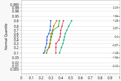

Hi - when I create a normal quantile plot using one way analysis, a connecting line is generated between the points, which is different from the Line of Fit. How do I remove this connecting line?

You can right click on the graph and go to customize. There you will be able to go to each of the Quantile Point Lines and then either change the line width to 0 or change the line color to white. Either of these will remove the color from the connecting line. However, the Quantile Fit Line and the Quantile Point Line are interconnected, and either of these options also removes the fit line from the graph.

Thank you! It's a little strange to have the two lines' properties connected, but looks like that's what we have currently.
