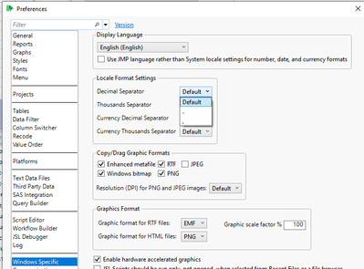

Those are just how your decimals are displayed in JMP.
If you are on windows you have at least these settings (I'm using JMP 17.2 on Windows 10)
https://www.jmp.com/support/help/en/17.2/#page/jmp/windows-preferences.shtml#
https://www.jmp.com/support/help/en/17.2/#page/jmp/mac-os-preferences.shtml# OS seems to have similar settings
