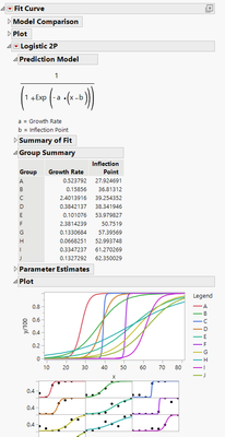

Regarding the non-linear question, you might have better luck with the Fit Curve platform, where you can see inflection points, do equivalence tests, compare parallelism, etc. I've attached a Fit Curve script to your original data table.

If you want to find the inflection point of the curve you can take the first derivative.
Getting first order derivatives
See help documentation for additional details:  Help-->Search JMP
MRB3855
Re: Modelling logistic data with GLMM and non linear platform
Hi @stan_koprowski : Setting 2nd derivative (wrt x)  = 0, then solving for x will get you the inflection point...
