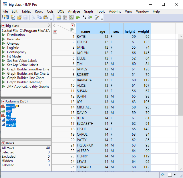

1. After inputting the data, go to the Columns Panel on the left side of the data table, and select all of the columns

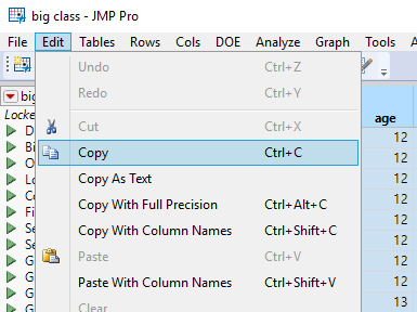

2. Go to the pull down menu "Edit" and select copy
