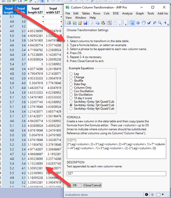

without JSL?
via Custom Column transformations from @ih's add-in collection:
https://community.jmp.com/t5/JMP-Add-Ins/Scripting-Tools/ta-p/410943#U410943
here is a wish to include this add-in collection in standard JMP:
https://community.jmp.com/t5/JMP-Wish-List/Custom-Transformation/idi-p/412010

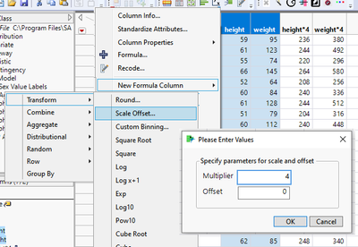

The easies way to rescale multiple columns at once: select the columns - right click - New Formula Column - Transform - Scale Offset ...
please note the meaningnful names of the new columns :)
If you want to change it to (... /100), you could do it manually or use @ih' s Rename Columns AddIn:
