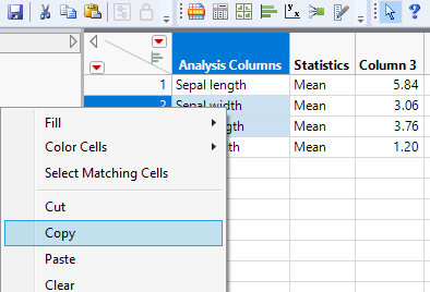

  • Select columns in the clipboard (useful if you copy columns from a data table and want to select them in a table)
  • Write the selected column names to the clipboard as a list or as one-per line

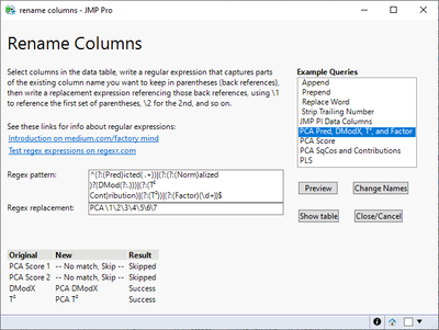

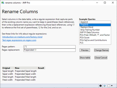

Rename Columns
Select columns to rename and pick from a variety of preset queries or write your own.

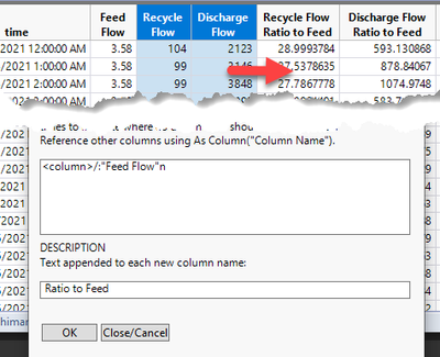

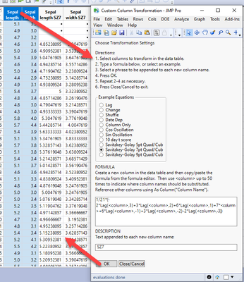

Custom Transformations
Select columns to transform and choose a preset transformation or write your own using <column> to indicate where to use the column name in the new formula.
Note: if you like this method of transforming columns, you can suggest making it part JMP here:Custom Transformation

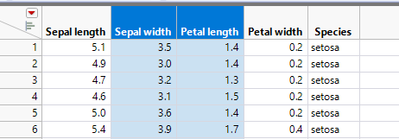

Column Names and Clipboard
Copy column names to clipboard and then run a script to select them in the data table.
Or select columns in the table and get the list of columns in one-per-line format that can be pasted in other applications, or in a JMP list that can be used in a script.
Sepal width
Petal length
{:Sepal width, :Petal length}
