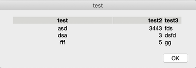

Re: Center text in a report
Using JMP 15.2 (on a Mac), with your code above I get (after stretching the column);
If I remove the 'setJustify()', I see:

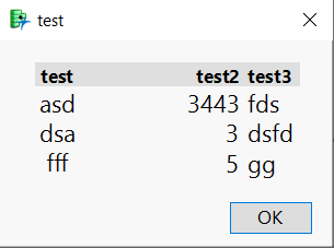

I'm using jmp 12 ... but even in jmp 15 the "test2" and "test3" are still not in the middle, you can see "test2" is not center, but aligned to the right.
is there a way to center all the columns?
