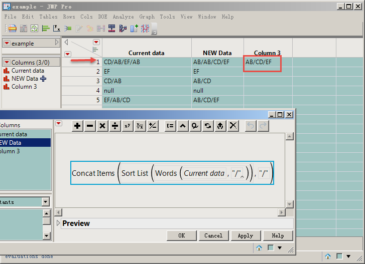

In addition to segmentation and sorting, does this formula add and remove the duplicated values after segmentation and keep only the fields that do not repeat?Such as:
Best regards.
txnelson
Re: How to split multi-word-values and re-arranging them in alphabetical order
No, neither solution specified removes duplicates.  That requirement was not part of the original request.
