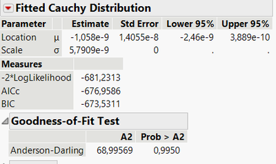

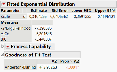

According to the JMP Documentation, the Cauchy distribution has an undefined Mean and Standard Deviation. Based upon that, I assume JMP does not have Cp and Cpk for that distribution and thus no need for the button.

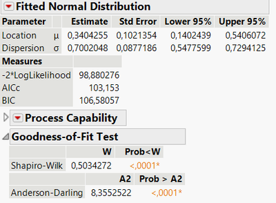

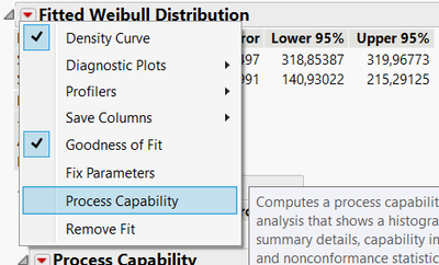

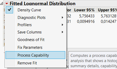

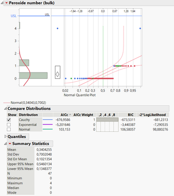

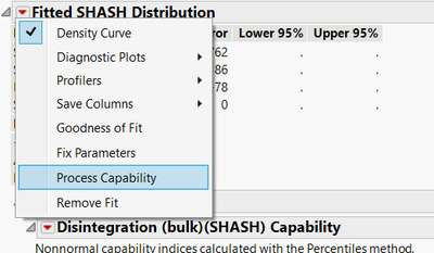

Yes, but then how do I calculate PPK? Should I take the nearest distribution, if it is? Or should I calculate PPK using Standard Deviation? I need to evaluate the process with nonnormal data distribution.
Have you tried fitting all the Distributions, and then determine which have a significant Goodness Of Fit? You could then use that distribution for your Cp and Cpk
Actually, the mean of the Cauchy distribution is defined but not the higher moments. So, no variance, no standard deviation. No standard deviation, no Ppk.
And, just as an aside, if you're responsible for improving a process that outputs data that are really Cauchy distributed, you might want to update your resume...
