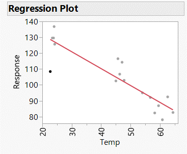

I still think that it's not what I am looking for. Allow me to elaborate

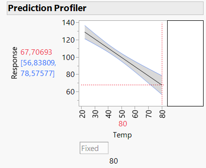

I can fit a model to my Response as a function of the temperature:
But I would like to calculate: If I fix the temperature to 80 degrees, what will the distribution of the response be?
