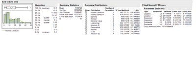

Hi have continuous data (processing time)
The Continuous Fit suggests the "Normal 2 Mixture Distribution"
Can I make a capability analysis with this distribution?
Thanks

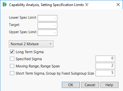

Yes, easily.  In the capability analysis dialog within Distribution, you'll be able to choose a distribution for the data.  Normal 2 Mixture is an option.Normal2Mixture.PNG

I'm using base JMP version 13.2.  You can also get the capability analysis for any of those fitted distributions by clicking the red-arrow icon for the fit and selecting "Spec Limits".  Setting those will generate a capability analysis.
-- Cameron Willden
