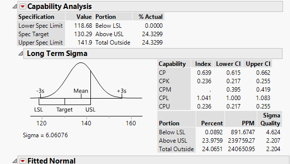

Thank you AndresGlez, using your code I was able to hide some of the columns, but not the rows. I'm trying to use Remove Element to delete the row, but that is not working. Below is what I have.

I have a control chart with a two column table with "Capability" and "Index" as headers with 5 capability indices listed below. I'd like to hide some of the indices and tried the below code, but it didn't work as expected. I've omitted some of the code just to make it shorter.
dt = Current Data Table ();
dt << Control Chart (
        Sample Label (:Date),
        KSigma (3),
        Chart Col (
                 :Name ("Test")
                 XBar (Show Control Limits (0)),
                 R ( Show Control Limits (0)),
                 Capability (
                    Distribution (
                          Continuous Distribution(
                              Column ( :Name ("Test")),
                              Fit Distribution (Normal),
                              Capability Analysis (LSL (0), USL (1), Target (0.5)),
SendToReport(
     Dispatch (
         {"Test", "Capability Analysis", "Long Term Sigma"
        "Index"
        NumberColBox << Remove Element (3)
        {Visibility ("Collapse")}

Here is my modification of your code........you are running JMP 14 apparently.  Anyway, my code deletes the 3rd element in the Long Term Sigma table
names default to here(1);
clear symbols();
cap = dt << Control Chart (
        Sample Label (:Site),
        KSigma (3),
        Chart Col (
                 :Name ("PNP3"),
                 Capability (
                    Distribution (
                              Column ( :Name ("PNP3")),
                              //Capability Analysis (LSL (0), USL (1), Target (0.5)),
capRP = cap << report;
numList = capRP["Long Term Sigma"][NumberColBox(1)] << get;
numList[3] = .;
capRP["Long Term Sigma"][NumberColBox(1)] << set(numList);
Jim

Is it possible to delete the sigma distribution graph?
Is it possible to delete an entire row in the Long Term Sigma, for example rows "CPL" and "CPU"?

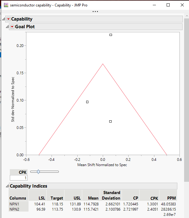

Here is a simple script that deletes row 2 of the Capability Indices table in the report
Names Default To Here( 1 );
cap = Capability(
	Y( :NPN1, PNP1, NPN2 ),
	Capability Indices Report( 1 ),
	Individual Detail Reports( 1 ),
	Capability Box Plots( 0 ),
	Goal Plot( 1 )
// Modify the Capability Indicies Table
// Delete 2nd row of the Columns column
columnsList = capRP["Capability Indices"][String Col Box( 1 )] << get;
Remove From( columnsList, 2, 1 );
capRP["Capability Indices"][String Col Box( 1 )] << Set( columnsList );
// Delete 2nd row of all of the Numeric columns in the table
For( i = 1, i < 8, i++,
	numList = capRP["Capability Indices"][Number Col Box( i )] << get;
	Remove From( numList, 2, 1 );
	capRP["Capability Indices"][Number Col Box( i )] << set( numList );
