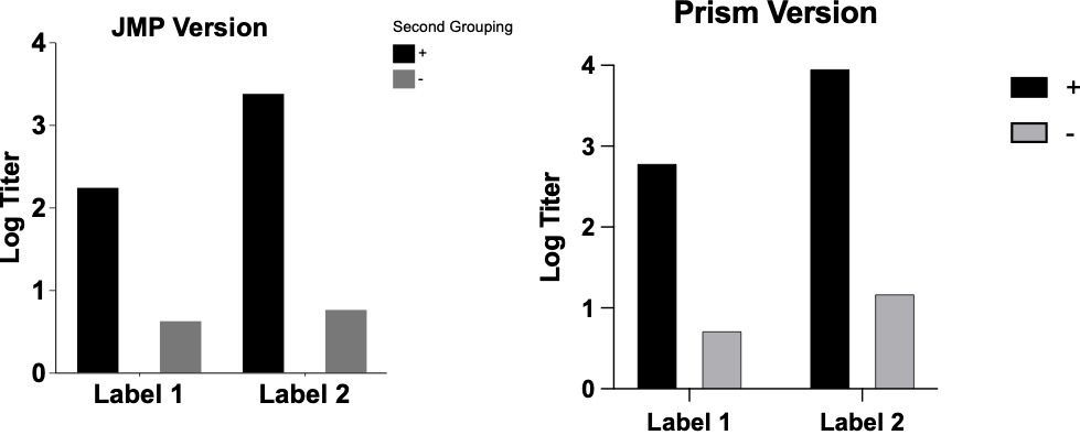

Likewise, I'm trying to solve a similar problem, which is tick mark weight and length. You see, my new bosses insist I present data in prism graphs, which I'm simply not going to do. Instead, I'm going to make it look like I used prism. I'm close to cloning the prism format with JMP (see attached), but need to increase the axis weight, tick mark weight, tick mark length and enclose box plots with a line. What is the best way to do this with JSL?
Ideally, I'd write a script called prismify which would convert an object to prism-like format, but that may be down the road.

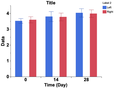

This solution works well except that the error bars then need to be moved (see attached).  Can I grab those and send them to "Set Side by Side Overlap"?

Yes, in fact you can do this more directly than what I showed previously:
Names Default To Here( 1 );
Open( "$SAMPLE_DATA/Big Class.jmp" );
obj = Graph Builder( Variables( X( :age ), Y( :weight ), Overlay( :sex ) ), Elements( Bar( X, Y ) ) );
//find all bar segment frames and adjust the distance between all of them
(obj << XPath("//BarSeg")) << Set Side by Side Overlap( -.8 );

Thanks! A note:
Elements( Bar( X, Y,Legend( 1 ), Error Interval( "Standard Deviation" ) ) )
The
must be in the script and legend has to be set to 1.
If not, legend not equal 1: off set error bars
If you run the script and use point and click to add error bars after the segment spaceing:  off set error bars
