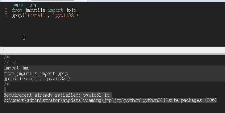

Re: Can python in a JMP environment get the vscode environment?
  • How to install pywin32?
pywin32 doesn't mean 32-bit Python it is a wrapper for the Win32 COM interface.  You can install pywin32 directly into the JMP environment which is 64-bits.
import jmp
from jmputils import jpip
jpip('install', 'pywin32')
from win32com.client import Dispatch
lala
Level IX
Thanks Experts!
