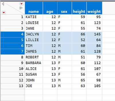

The easiest way that I find to do this is if I have a mixed selection like this:
Then click the null-space in the upper-right portion of the first cell (see the red circle here) to deselect the columns -- this changes the selection from a selection of CELLS to a selection of ROWS.  Pressing delete now will delete the rows entirely instead of clearing the cells.

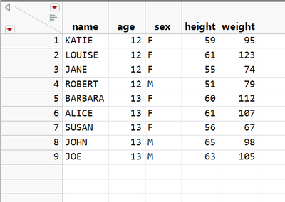

after pressing delete:

Likely what you did is delete the cells rather than the rows -- if you select rows and press the <DELETE> key then it will do what you want.
