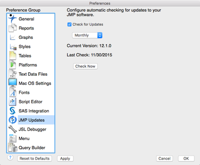

The JMP 12.2 updater will be available at jmp.com/update during the week of 14Dec.
Turn on the preference to have JMP check for updates to stay up to date.

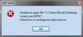

I just installed JMP 12.2.0 (Win 7 Professional - 64 bit) and tried to open this Minitab dataset​ (*.MTW) via the Open menu but gave me the error message below.
Appreciate the guidance.

Hi Randy,
You must have a recent version of Minitab installed on the machine where you are trying to open the file.  JMP asks Minitab to open the file on its behalf. If you do have Minitab installed and you could share the file, then please contact Tech Support and they will pass the file along.

Re: Can JMP open Minitab worksheets (*.mtw)?
Thanks Brian !
The mtw file was opened successfully in JMP after installing Minitab.
