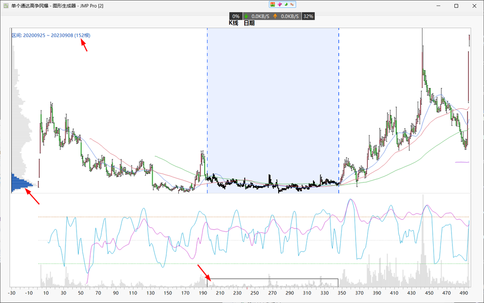

Can JMP graphics have this effect?
This is the HTML effect.
Can JMP graphlet achieve this effect?
Thanks!

@SDF1 thanks! You can use a 2nd script argument to mousetrap to detect the button release and remove the graphic script. The first script is called for mouse down and each subsequent mouse move. If the second script is given, it is called with the same parameters to indicate mouse up.

I never expected that gemini3.1 pro could complete this masterpiece.2026-08-10 19_29_45-截图编辑.png
