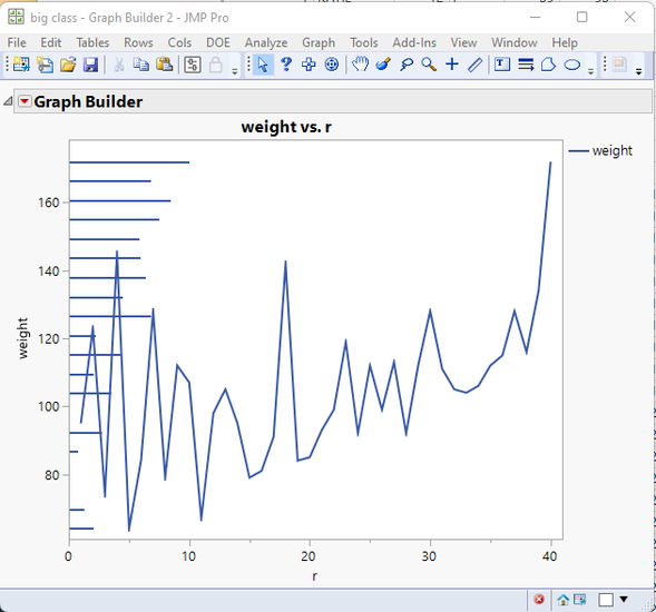

txnelson
Re: Can JMP draw this pattern?
Here is my attempt.  It creates the needle chart transforming the Height and R values to match the range of the Weight and .25% of the r axis.  The a FrameBox copy is done from one graph to the other;

lala
Level IX
Thank Jim!
This is exactly what I want.How do I change the color of GB1 (bar chart) to red?I still haven't learned.
txnelson
The lines are combined with the line chart, which means whatever the line color is, the needles will be the same.
