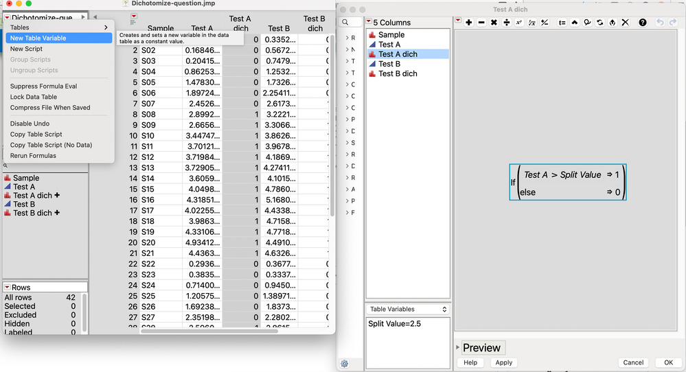

Hi,
Using a "table variable" is one way this can be done. Using the table's red triangle menu, add a Table Variable. I called mine "Split Value". Set it to some initial value. Then, when entering your dichotomizing formula, use this variable name (you can double-click on it in the editor's interface) instead of a hard-coded value.
When you want to change the split value, just double-click on its value--it will appear in the data table window's upper left corner--and change the value. The categories will update when you've accepted the new value.
I've attached a table where this approach is used.
Cheers,
Brady

Re: Can JMP automatically dichotomize continuous variables while making contingency tables?
This is a good option. I didn't know about table variables! One thing that I like to do is save a script for each of the analyses; in this case, that would be at the different values of variable "Split Value". So there'd be a script for when it's set to 3, 4, 5, etc.  Is there a way to achieve this? I'm not afraid of a little light scripting if that's what would be required.

The answer is "yes", but before you go that route, try this:
1) Implement the table variable and formulas as described above.
2) Run the analysis you want. In the ensuing report, click in the upper-left-most red triangle menu and select Redo > Automatic Recalc. By selecting this option, you are telling JMP to refresh the report whenever the data table changes.
3) Leaving the report open, update the table variable to various values. Since this changes the data table, it also updates the report... so you can run a single report and interact with it just by changing table variable(s).
4) If you like this approach, save the report's script to the data table using the red triangle menu, and you're done.
